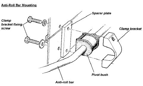

Dan, are the earlier ones the white, Nylatron type square ones?

tut wrote:Dan, are the earlier ones the white, Nylatron type square ones?
Nylatron is black, if they are white they will just be white nylon, nylatron should be better as it is a bearing plastic with oils n' stuff (technical term) for lubrication.

Re: S1 ARB bushes and brakes
Post by Mikie711 » Tue Oct 27, 2009 6:48 pm
Rich as dan said just the front undertray to remove. Just peel back the wheel arch liner to gain access to the bolt head for slackening. Easy enough job and doesn't take long just make sure the ARB and bush are clean before re-assembling.
Yup tut, early ones are white Nylon, the late S1 ones changed to these totally different ones (dont use the wishbone bolt).

Post by Tom » Tue Oct 27, 2009 8:30 pm
What year did they change Ali? Mine will need doing soon and I wasn't aware there was a difference. Mine is Sept 98.

Post by roadboy » Tue Oct 27, 2009 9:00 pm
Tom wrote:What year did they change Ali? Mine will need doing soon and I wasn't aware there was a difference. Mine is Sept 98.
Pretty sure they'll be the later type Tom. But you never know with Lotus. :roll:

Post by alicrozier » Tue Oct 27, 2009 9:01 pm
Not sure mate but pretty easy to check on the car.

Post by tut » Tue Oct 27, 2009 9:30 pm
Check your VIN number Tom, new ones were from W 3039.

Post by Tom » Tue Oct 27, 2009 9:37 pm
tut wrote:Check your VIN number Tom, new ones were from W 3039.
Jolly good. I've got W 3442 :thumbsup
