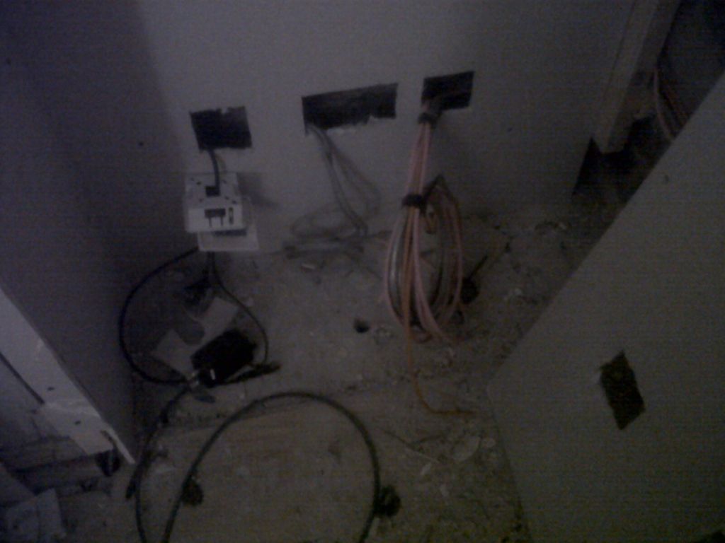

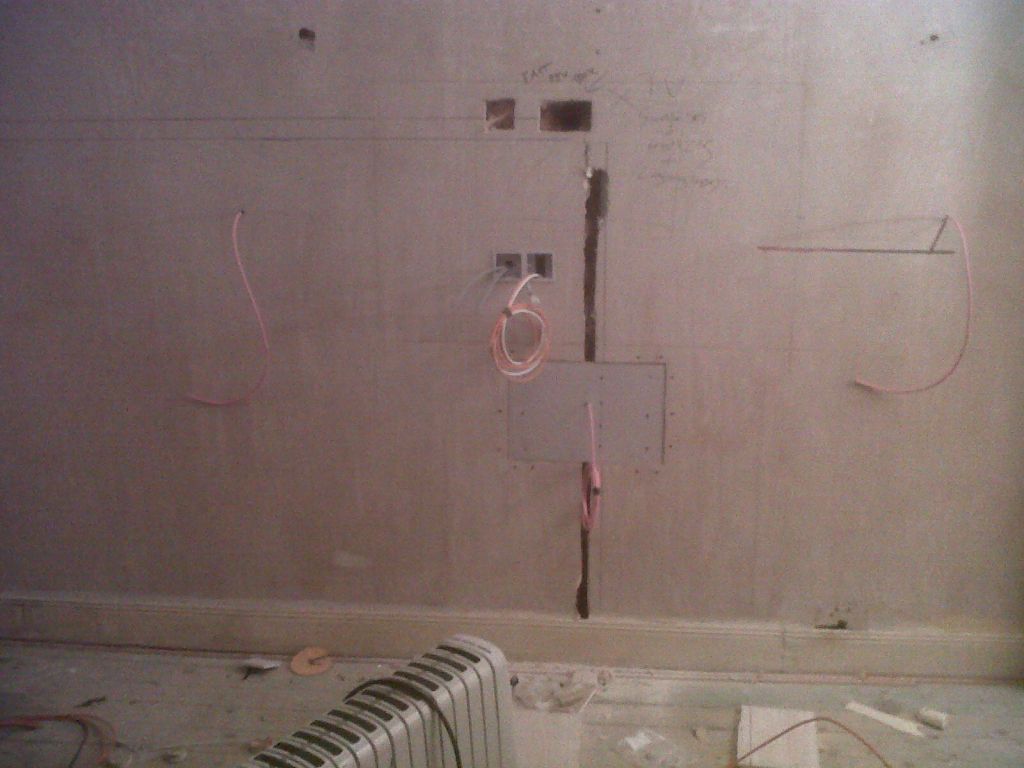

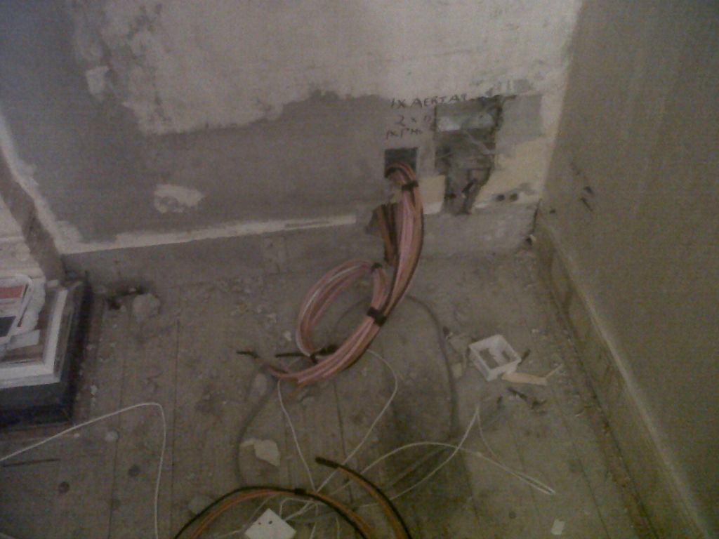

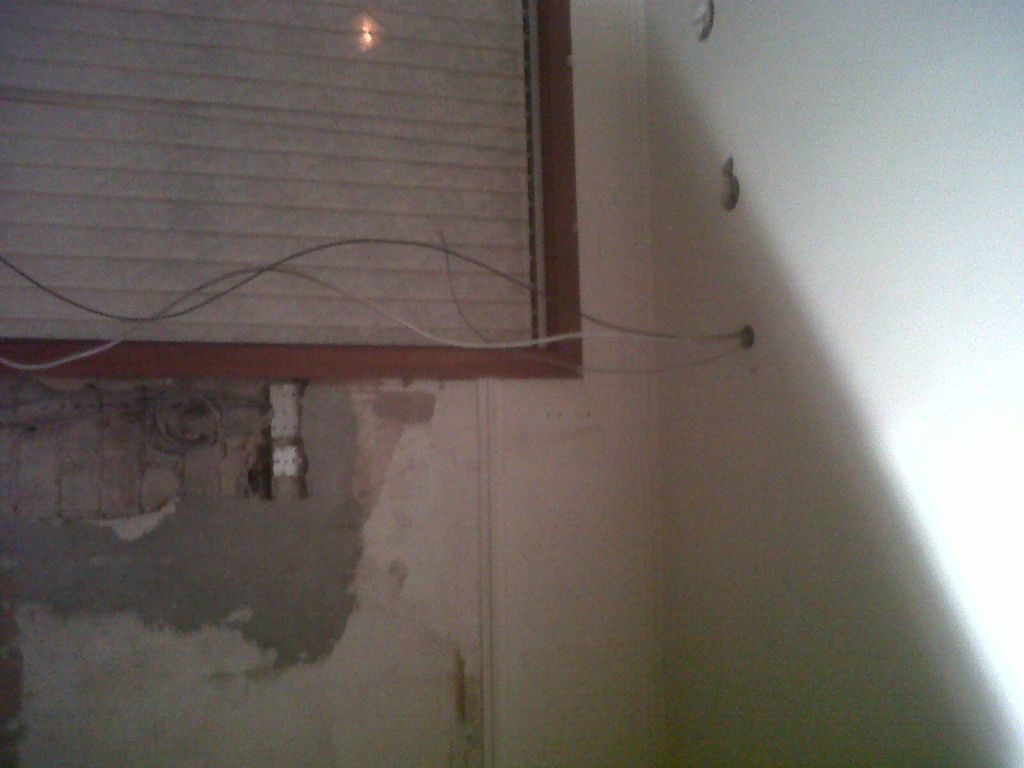

Well started on Saturday at 9am and finished around half 7 in the evening and got the first fix done. We have wired the house for cat 6 so have a point at the aerial point in the two bedrooms upstairs, a point in the to be boys room running to the projector and a point in the main living room where all the cat 6 cables run to. Also have both rooms downstairs wired for 5.1 surround sound and have the hdmis ran in for the projector and tv in each room and will be using a amp as an hdmi splitter so all inputs go to the amp with one output to either the tv or projector. Used around 85 meters of speaker cable and 85 meters of cat 6 so hopefully covered all avenues. Crappy blackberry pics of the current state when we where almost done, need to get better images when I tidy it up. We moved where I anticipated to mount the tv which was too high to a lower more suitable position on the wall following the advise on here and the av guy. I guess many mount the tv's too high as it looks so low, and the high ceiling probably exaggerate this.
