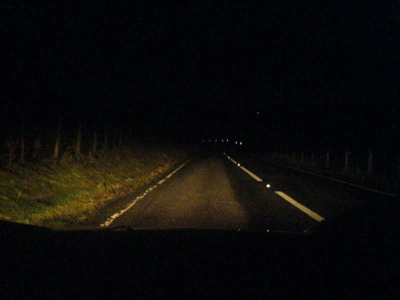

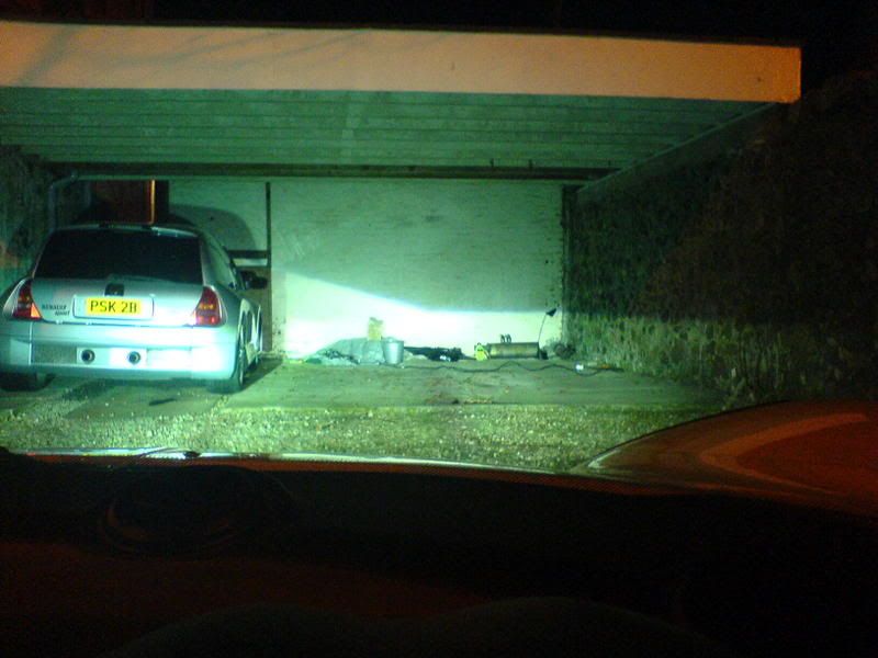

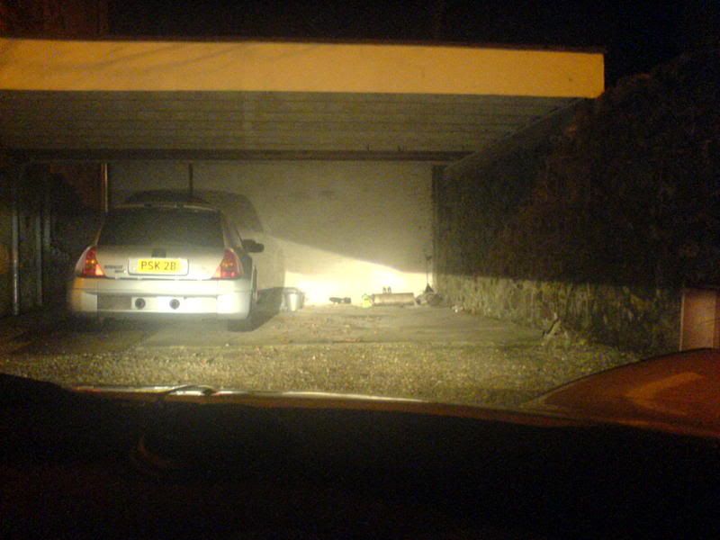

Got a set through the SELOC group buy, and fitted them the other night.
Was pretty straightforward, I guess if the car had been older it would have been a bit harder as even some of my bolts were a bit rusty.
I had not seen a decent "before and after" type post on any forums, so thought I would take a couple of shots before and after to show folk who might be interested the difference. Oh, and they were taken with my phone so probably dont show up as good as they could have.
Taken on the same night (in as near as I could remember to the same spot) each time :lol:
OK country road before
More or less the same bit but with the HIDs

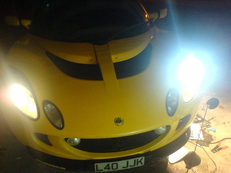

Half way through (lamp cover removed)
close range before and after, not as noticeable (apart from colour) as the country road shots.
All in all a thumbs up from me. Hope that helps if anyone is thinking about a kit!

Pretty straight forward, much the same as changing the bulbs if one had blown. Only need to take off the wheel and remove the liners and lens cover (which you have to do to change bulbs anyway).
All HIDs (factory fit and kits) need ballasts, apparently they chuck out a billion volts and can kill you. Cool. Oh, and they make that really cool flash when you turn them on.
Post by simon » Mon Jan 29, 2007 9:53 pm
jj wrote:Only need to take off the wheel and remove the liners and lens cover (which you have to do to change bulbs anyway).
I can't remember if the Exige is different but you don't need to remove the wheel to get the headlight covers off on mine.

Exige is different, the wheelarch liner is one piece with the ducts in it and you cant get that off with the wheel on.
Dip beam only, with full beams on theres no need in my opinion for both to be HID and it makes it silly money.
Ballasts get screwed ( 3 self tappers) into the crash structure next to the Radiator.
