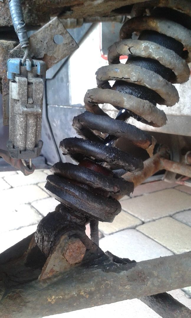

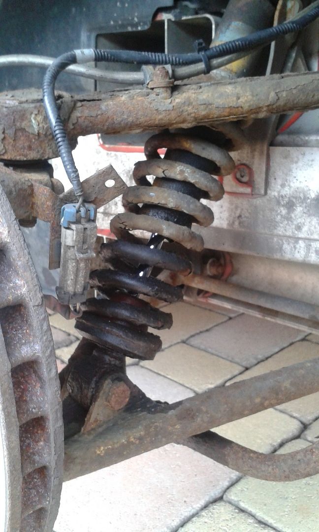

During my drive home the other day, I felt the ride was particularly harsh (even for Edinburgh's streets), so I jacked it up today for a wee look and found this on the front offside.
My guess is the the damper needs replaced, but has anyone got any other advice (bearing in mind I'm a complete numpty when it comes to repairs, so it will probably be going to MMC for the work)?
Is it advisable to replace both front dampers at the same time, or even all 4 (the others look OK, although there is some surface corrosion).
Duggie

Fancy letting it get into that state........... :D
Re: New Dampers?
Post by woody » Sat May 02, 2015 4:26 pm
Both fronts at the same time minimum, but guessing they're original all 4 would be better. Bilstein do an overhaul service but they look particularly poor cosmetically at least so new could be the better option.

Even I can swap out dampers. 2 bolts, 1 top 1 bottom. Note how the "top hat"'washers are arranged.
Report back when finished pls :-)
Swap in pairs as minimum.

They look terrible!
I had all 4 replaced by MMC last year, they looked nothing like that but the ride was horrible.
It was about £200 / corner incl fitting & vat & alignment.

Even I can swap out dampers too. I borrowed an impact wrench to do it, as those corroded nuts can be a bit of a bugger.

OK, I get the impression that it's a pretty "shocking" state of affairs down there.
I reckon, if it was just a question of replacing a damper (or two), I could give it a go, but I've got a feeling there might be more work required so it's off to MMC for some TLC.
