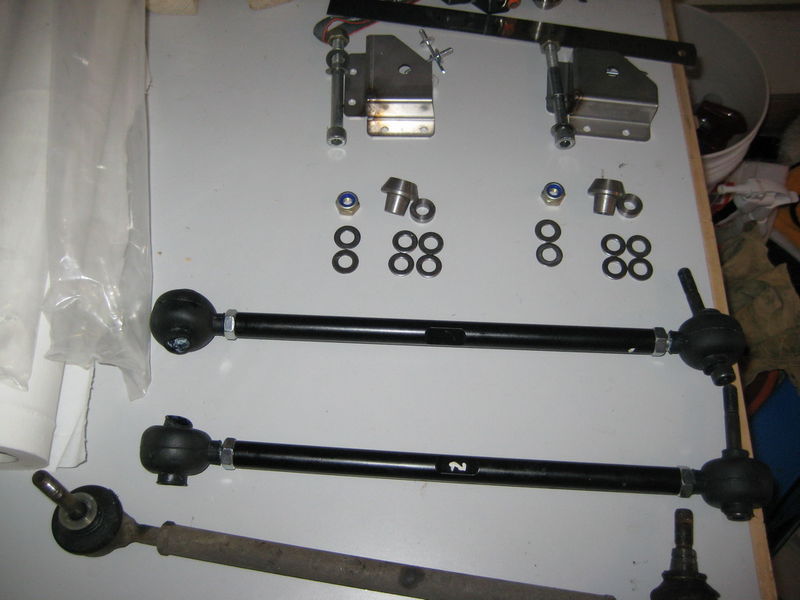

I think they may be different as the S1 doesn't have a tapered ball joint going into the hub. It's the balljoint bolt that grips tighter when tightened which is why they can be difficult to get out. The eliseparts kit seems to supply one as in the pic below. (The large tapered spacers although this is quite an old pic) Although I'm not sure how critical the taper angle would be.
The current kit shows these.
I'm sure an expert who has fitted the kit will be along to tell us soon. 8)

I'm pretty sure that the tapered aspects are the inboard washer / spacer between the ball joint and the subframe. ( this may be redundant if you install a double shear bracket) and the tapered spacer between the ball joint and the hub. Have a look at yours and establish if the hub on the S2 has a recess. If it does then I suggest either buy the spacer from Eliseparts or speak nicely to Stu. I opted for off the shelf rose joints to allow me to replace them cheaply if required rather than being stuck with a single supplier.
