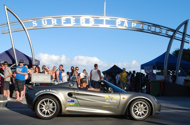

Re: Secure storage box
Just a can of spray paint away ha ha
