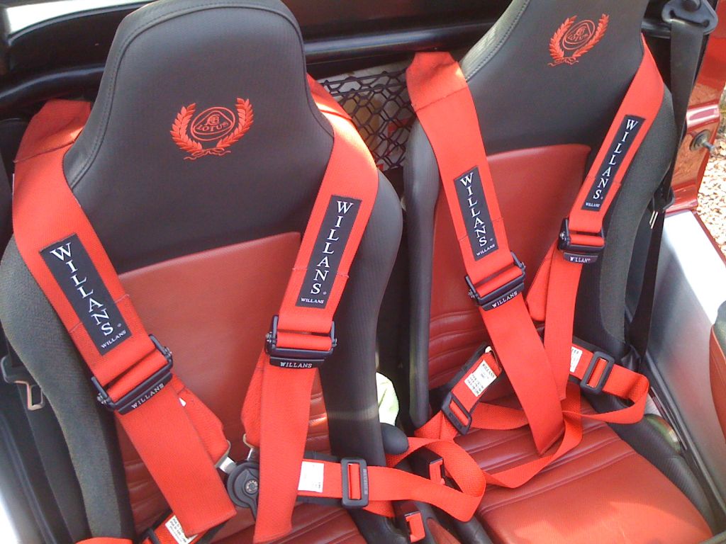

Looking for some advice on fitting a set of harnesses to the Elise.
Iv'e got a nice set of Schroth harnesses that I am looking to fit to the Elise using a bolt on harness bar but the harnesses have snap in brackets as opposed to the bolt on ones I need. Schroth sell various types bolt in bracket but Im not sure which ones would fit the Elise Harness bar and Seat best.
Can anyone who has a bolt in harness either take me a picture of the brackets supplied with Lotus specific harnesses and how it attaches to the bar and seat or if theres someone local with them fitted can I pop round for a look?

By the the sounds of it you need the bolt in eyelets. That's what I have on mine, will take a pic later.

Dominic wrote:In fact a quick google; something like this; http://www.shawsmotorsport.com/racing-c ... -727-p.asp
No Dom, hoping to attach them like in the pic above, think Im looking for some type of bolt in bracket like these:
http://www.schrothracing.com/store/Comp ... n-hardware
Just not sure which one come with Elise harnesses. Pics of these please were they attach the harness and the seat would be appreciated.

Ah I see! I have the eyelets for my harnesses so a pic prob won't be much use for you.

I ended up going that way in case I had a situation where I wanted to keep the three pointer in and occasionally remove the shoulder straps to stop them getting in the way. Ended up taking out the three pointer anyway. Much less hassle going that route and keeping the removability if you do intend to keep the three point in there.
