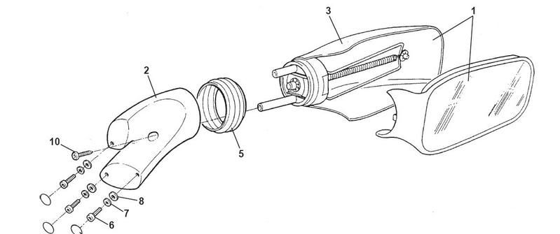

I think what's happend is before I got the car I think someone my have kicked of the mirror. It has been glued back on to the painted bit but it won't move so I can't see out it unless I lean way forward.. So can I buy a new mirror and put it back on the painted bit??

craigs135s wrote:I think what's happend is before I got the car I think someone my have kicked of the mirror. It has been glued back on to the painted bit but it won't move so I can't see out it unless I lean way forward.. So can I buy a new mirror and put it back on the painted bit??
C
Here's the "exploded" view - you should be able to work out what you need from here.

Cheers rob. Looks like I need mirror unit and the rubber round bit.
