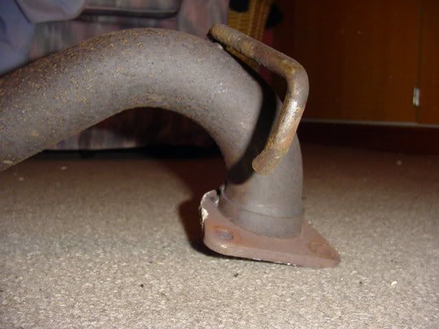

Post by DDtB » Tue Mar 07, 2006 12:52 pm
I may have been a bit of a donkey here....
just bought this..
and noticed that it has two pipes on one end.....
that's not gonna fit my std s1 is it!?!?
suggestions...??!?!?
:roll:

Post by DDtB » Tue Mar 07, 2006 1:08 pm
Blokey advertising it said it was a std Elise s1 downpipe....
hmmmm...
bugger!

Post by Shug » Tue Mar 07, 2006 1:21 pm
I can't see the photo either, but I think my standard zorst did have a 2 pipe flange between the manifold and the downpipe. Memory is hazy, but don't think the worst - it may just fit.
Remember, the only difference from the S1 elise engine install and the MGF was the tailpipes were different (to fit the central exit) The whole zorst system was MGF.

Looks the same as mine. The mgf one has a slightly different bend at the cat end. I bought one before and it didn't fit right. Hard to tell if is MGF or Elise without seeing the 2 of them together. But mine def is a 2 into one like that.

Post by Rich H » Tue Mar 07, 2006 5:43 pm
This fit mine ok until the flexi went. 2 pipes off the manifold, not good access for spanners (Of all types :oops:) and the studs came out with the nuts attached on 2 out of 4. Replaced with SS bolts satis. Halfords firegum with a new gasket is a good idea too. Close you eyes if you are under the heatshield or manifold when you touch it or be prepared for a rust/fiberglass shower. I read somewhere later MGFs had 6 bolts into the manifold, but I might be talking sh*t.
Good luck!

Post by mac » Tue Mar 07, 2006 6:13 pm
Dave,
TBH I though (without aid of the picture) that it was a manifold that you had bought with the double flange on the bottom.
IIRC it's the same as the one on your car - Actually No, it'll never fit.

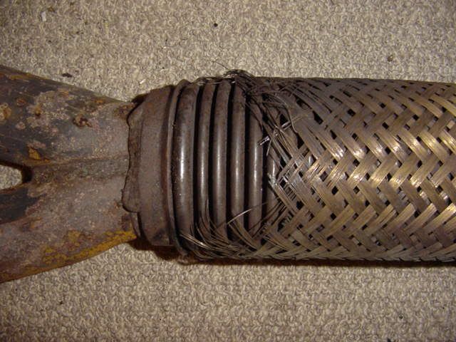

Post by Rich H » Tue Mar 07, 2006 6:25 pm
Mac,
Mine's not cracked but the flexi woven stuff is fcuked and tizzes at 2.5k revs ish. yours for free if you want it. I'll even throw in some old SS bolts that'll fit.

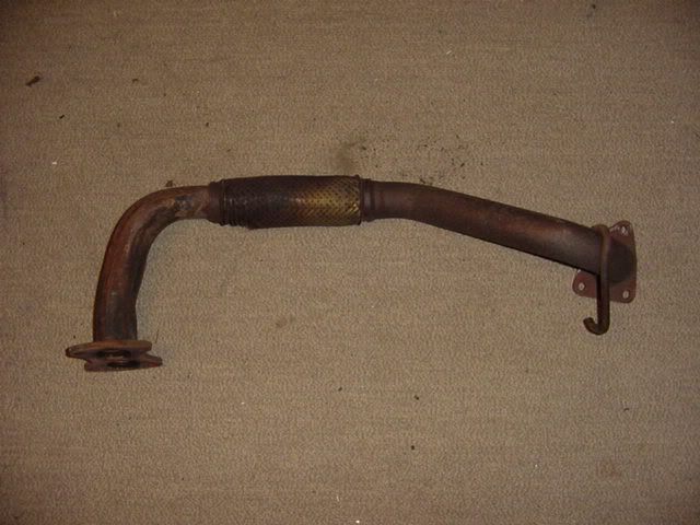

Post by Rich H » Tue Mar 07, 2006 6:28 pm
For those that can't see the piccy its a flexi link from an S1 or MGF...
Like this but shiney and less fcuked:
Close up on the off chance someone wants it: (Mac: hint-hint :wink: )
