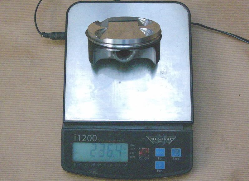

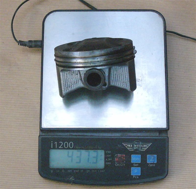

............... and this is why the honda does not deliver that quality to me...
the honda piston
437gmm.............. a ton
that means two things, it's one hell of a mass to hang on to..........for rod and crank
it makes for very high secondaries - Secondary forces off vibration are particularly insistent [nasty] because they happen at twice the frequency of engine speed - in laymans terms this engine is not refined at all.

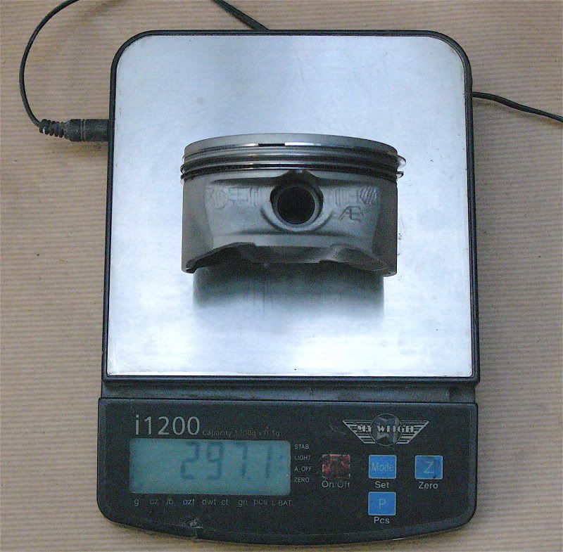

By comparison a k series piston
297gmm, that means the issue with secondaries is not an issue, the engine runs smooth, plus the rod crank are not nearly so stressed hanging onto it, and the crank therefore needs much less counterweight, which means a lighter engine and a more responsive - freer revving engine

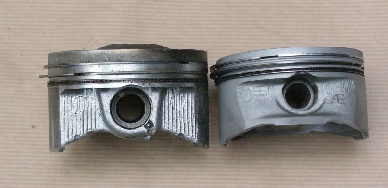

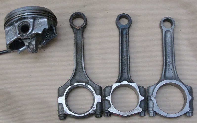

And now to the rod
left honda K20A2 rod, middle K series 1.4L rod, right K series 1.8L rod
note how the honda rod is narrower than a 1.4L K series rod, and Rover saw the need to beef that up for the 1.8L!
the honda also uses the anachronistic 20mm pin, not seen in modern production or competition engines for 40 years!
- so what happens, honda rods beak under the pin, this piston and broken roda out of a Honda'd Elise competing in Lot, it made a mess, caused a big fire, and it is NOT uncommon, I have 5 honda blocks that have thrown rods all out of Elises.

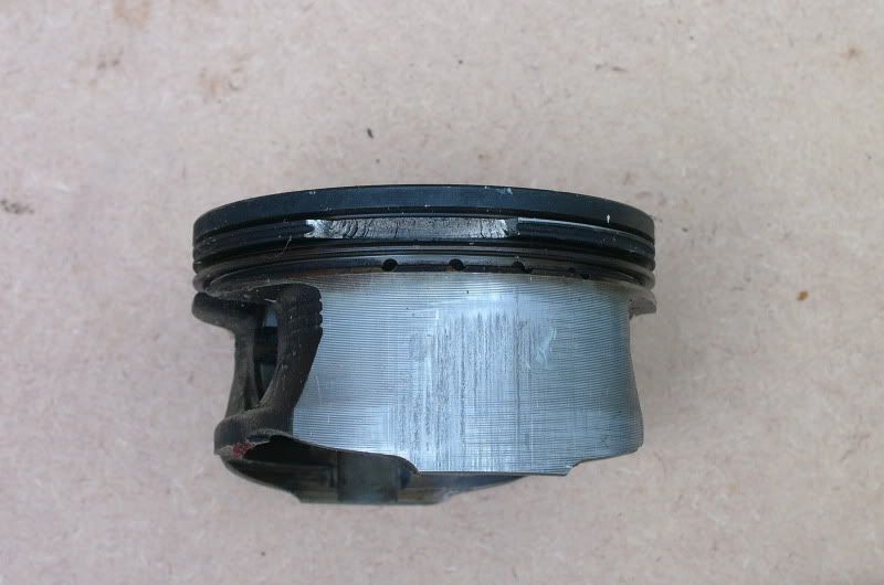

In addition.......
A K20A2 piston next to a K series OE - look at how little metal there is under the gudgeon pin on the honda, that has to hold onto the piston at the top of the stroke - has to take all the inertial loads of a crude heavy heavy piston, and guess what, - it breaks.....
Got one here that did just that, again out of an Elise, broke the valves, trashed the head, broke the rod, holed the block, set the car on fire......
can't find that piston to photo at the moment, but it is here so picccies coming..

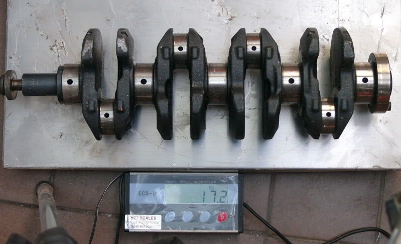

And here is where it all begins........
the monster of the honda crank
undercounterweighted, 365gmm at rear, 185gmm at nose out of balance, not doweled and 17.2kg

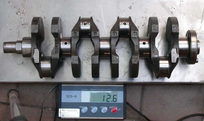

and here is the OE K series
- undercounterweighted, 80gmm at rear, 20gmm at nose out of balance, doweled, 12.6kg
