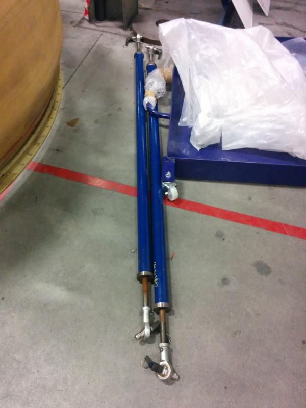

Found these. Any use?
BigD
Posts: 3209
Re: S2 Toe Links
Post by BigD » Fri Oct 03, 2014 6:02 pm
They look a tad long woody. :)
