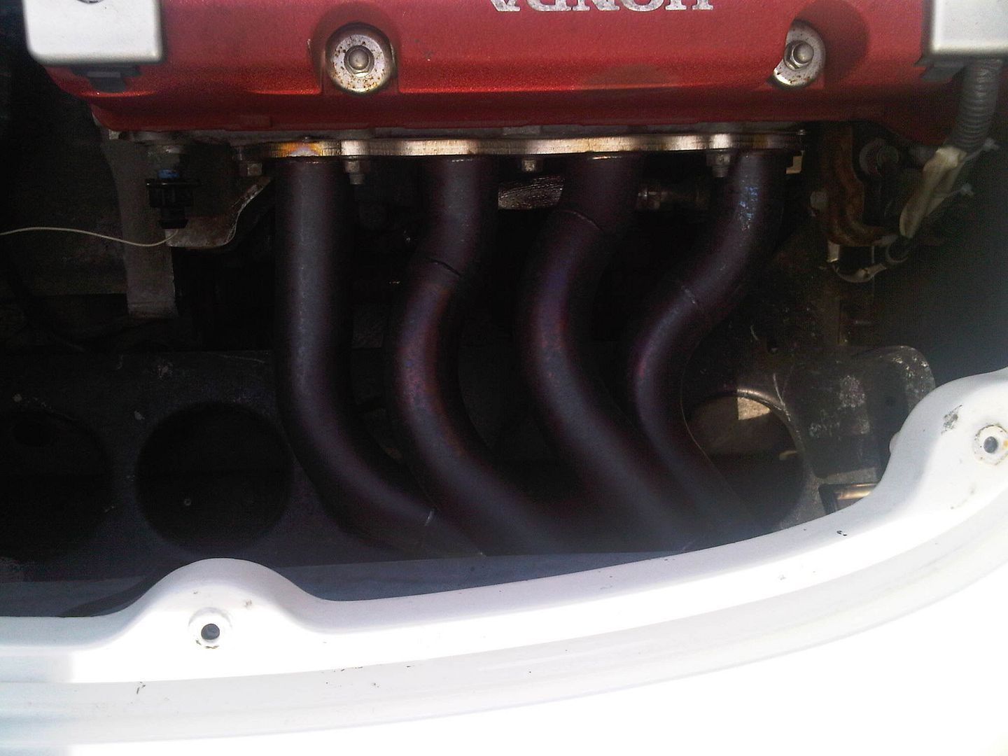

Post by Sanjøy » Sun Apr 25, 2010 4:16 pm
Quite a few Hondas now, 10 ?
Off to take pics as requested earlier in the week.

Posts: 8830
Re: 340R Colin's Honda Conversion
Post by Sanjøy » Sun Apr 25, 2010 6:40 pm

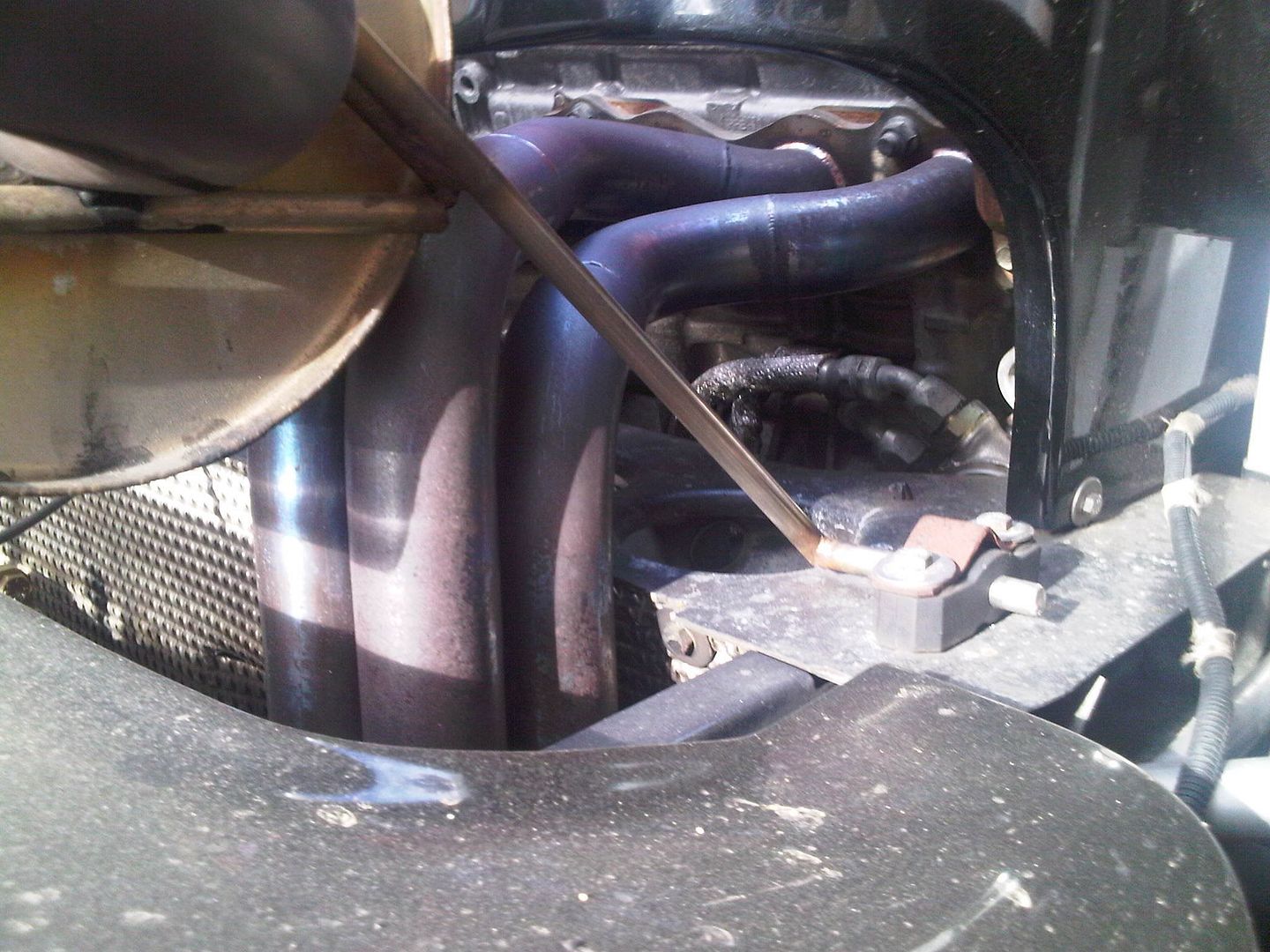

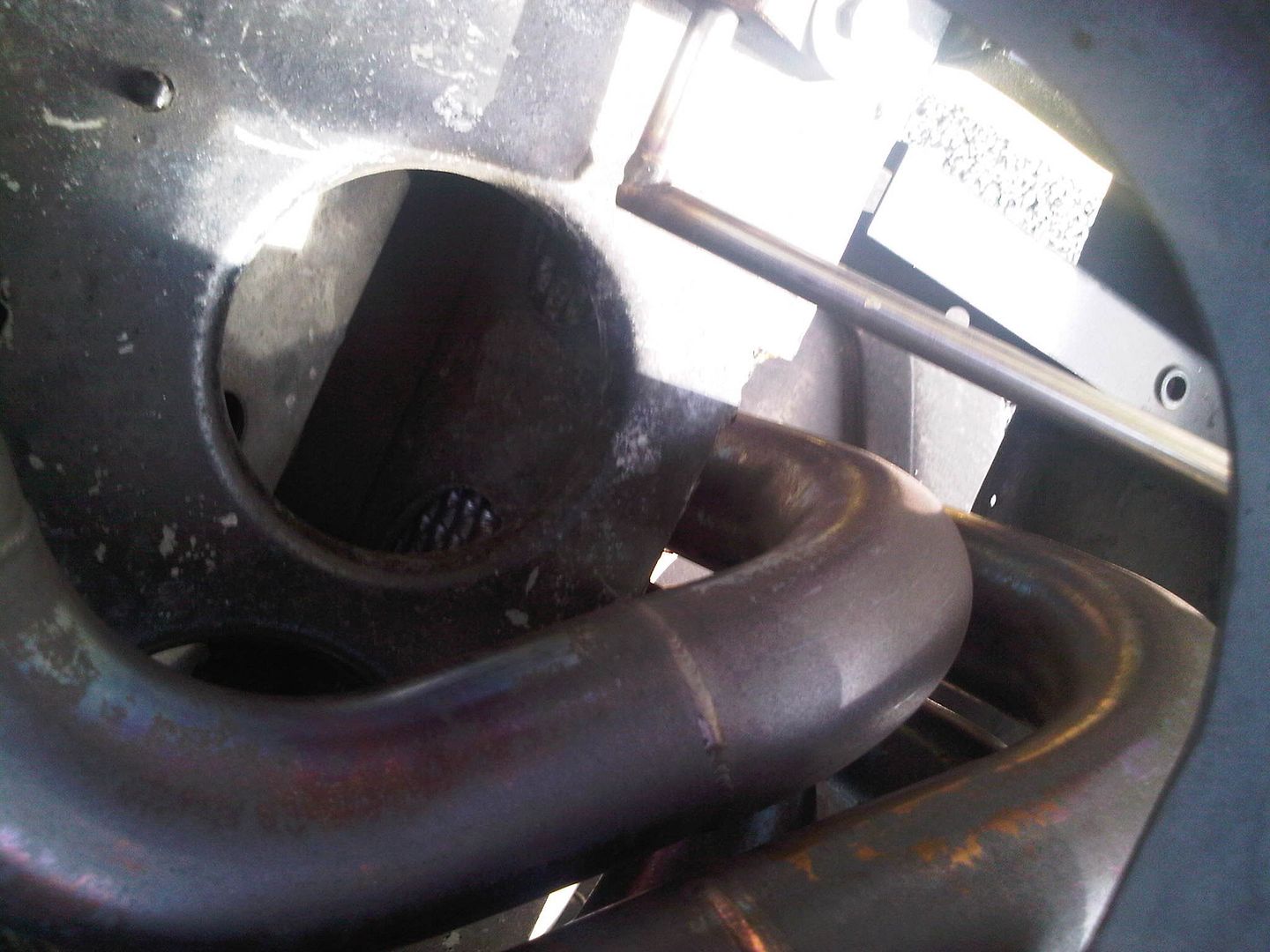

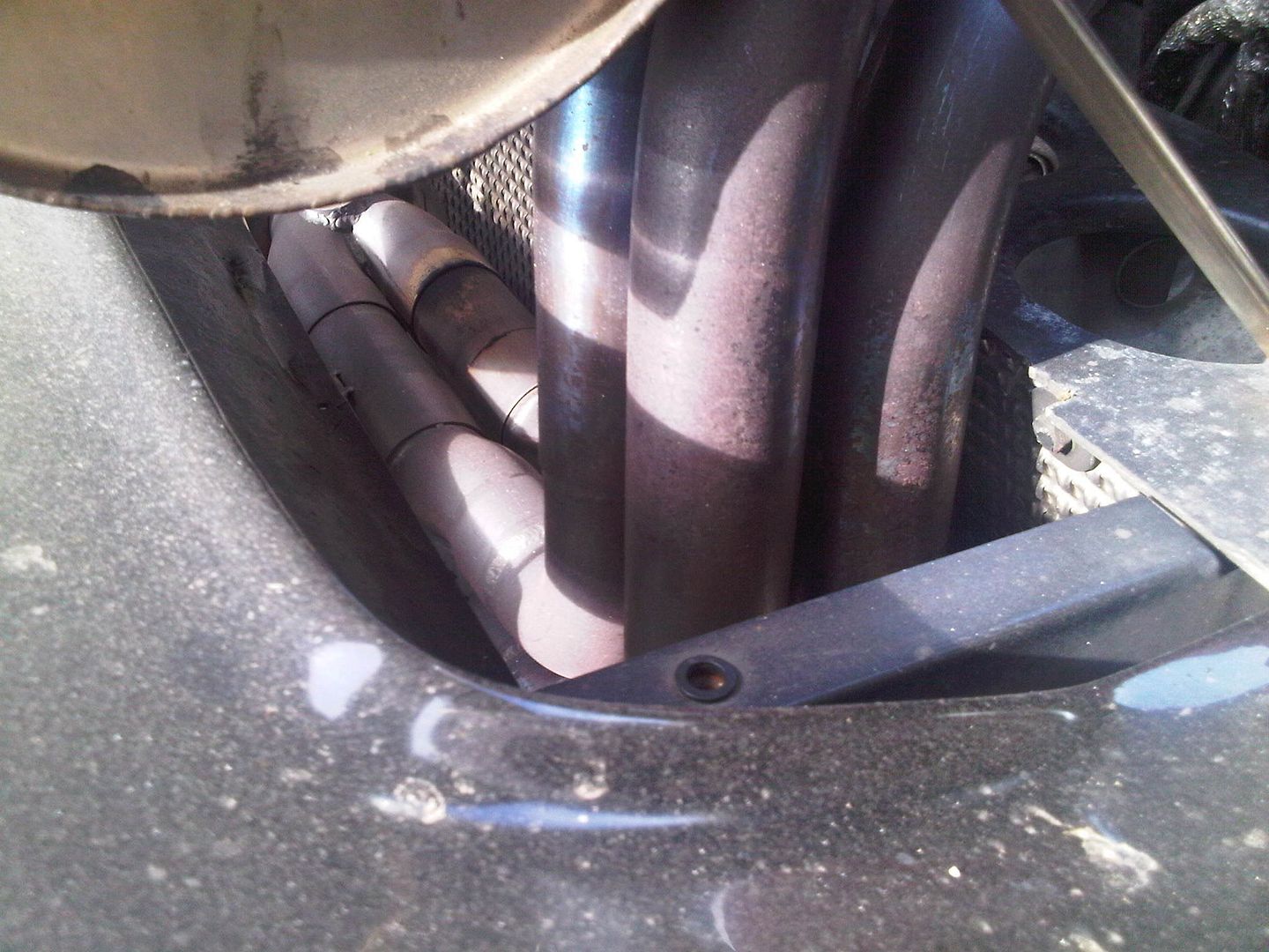

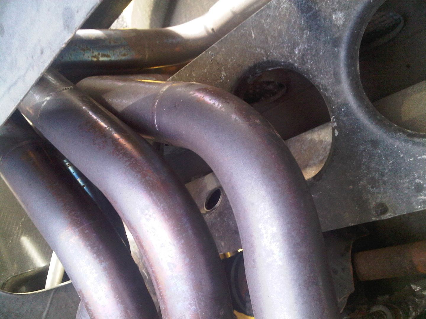

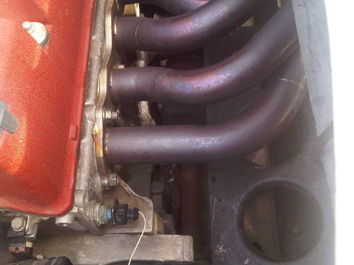

Gourlay83 wrote:
Sanjoy wrote:Let me know if I can help with any pics.
S
Jim's Exhaust would be great. Trying to figure out if we can keep his Silencer
Alan :thumbsup

He did say that they have not had a failure yet using the MG Rover Outer. So had to explain it was for Colin (Car Destroyer/Banned from AA) Murray :D
Thanks for the pics Sanjoy :thumbsup
