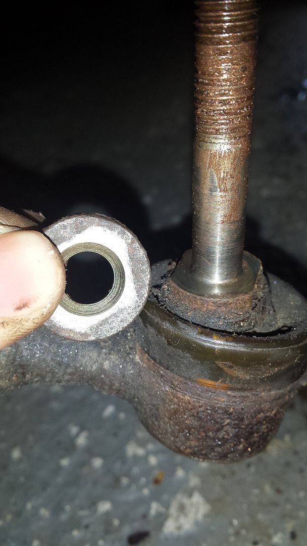

Ive just done a wheelbearing on the NS rear.
when i took the outer toe-link off the hub, i noticed the spacer (approx 10mm) was above the hub, ie under the nut and not on the balljoint side with the shims.
I have the later type of balljoint with the integral stud.
Ive checked the manual and it looks like this is wrong and that it should be on the underside so that it acts with the shims. But its not 100% clear. My 'conical spacer' doesnt appear to be conical, and the plain washer has a countersunk hole which is a bit random and it seems a bit thicker than i'd expect a plain washer to be so im not sure if that goes on the top or the bottom.
ive checked the other side and they have both been set up the same so here iam asking for assistance.

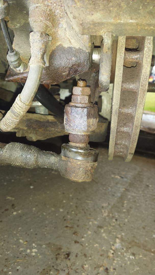

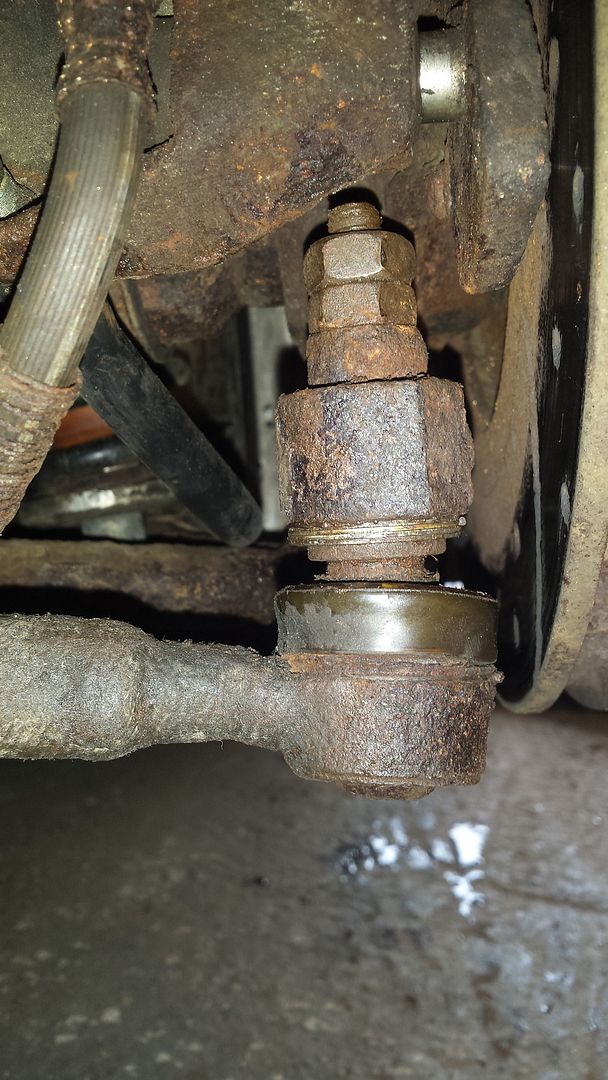

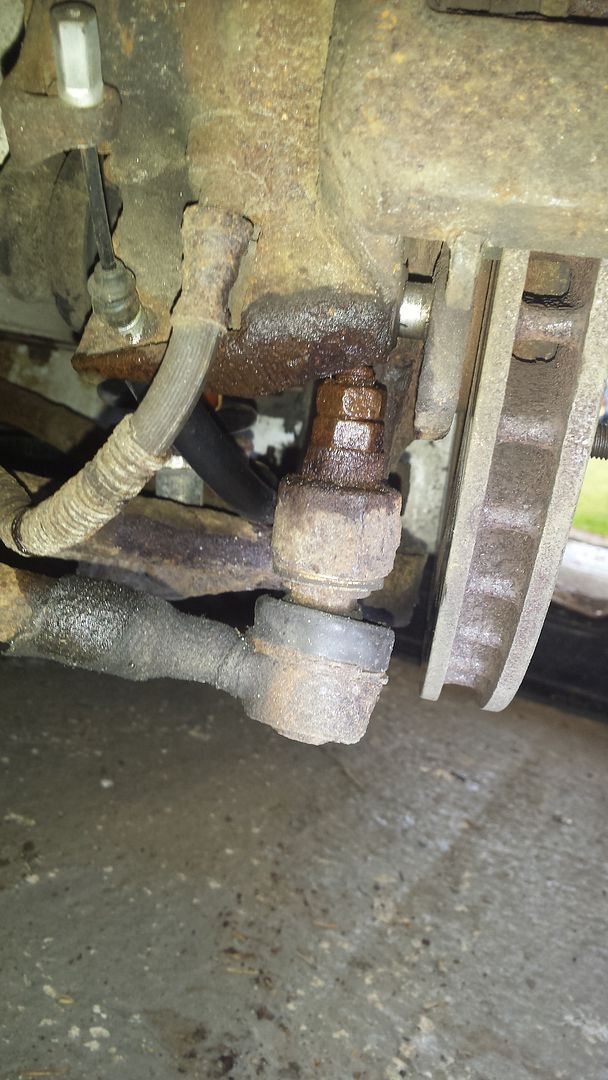

Post by 2F45T4U » Sat May 30, 2015 6:38 pm
After and before shots, but what one is right? can someone check their car and let me know?

Post by Stephen » Sun May 31, 2015 9:50 am
Here is mine late S1 all be it snapped!

Post by 2F45T4U » Sun May 31, 2015 9:56 am
Thanks for that Stephen.
Seems mine were right the first time. The spacer must go on top to give the bolt some stretch.
Re: S1 rear toe-link balljoint hub spacers.
Post by robin » Sun May 31, 2015 11:19 am
I think you are misunderstanding the spacers. In your most recent pictures (after/before) I am not sure which is which. I believe the first picture to be incorrect and the second picture to be correct - the thicker spacer goes between the nut and the hub.
See this assembly diagram:
The correct stack up during assembly is:
Balljoint [40]
Conical spacer [38] with chamfered/countersunk section facing the rubber boot; this part should be about 3mm thick; it's the part nearest your pinkie in the original photo of the spacers and you have it chamfered face up in that picture.
Bump steer washer stack [37]
Hub carrier eye [1]
Thick spacer [39]; this part should be about 10mm thick.
Nyloc nut [12]
Note there is no washer underneath the nut in the assembly diagram.
I once got some flak for putting a bunch of unused bump steer washers between the nut and the 10mm spacer. Personally I can see no reason why any number of washers here will make a difference, but apparently that's why the toe link kit failed ... so it's up to you whether you put 0, 1 or more washers into that gap.
AFAIK the point of the 3mm spacer is to allow for a small radius on the balljoint root (where the stud meets the ball). If it weren't for the chamfer/countersink in the spacer then this root would have to be machined to be perfectly square, or the washer/spacer/hub would get jammed on the radius during tightening.
The conical aspect (which is visible in the diagram you posted) has been "superseded" by simply using some bigger washers that can adapt directly from the diameter of the 3mm spacer to the diameter of the eye in the hub.
I hope this is both accurate and helpful.
