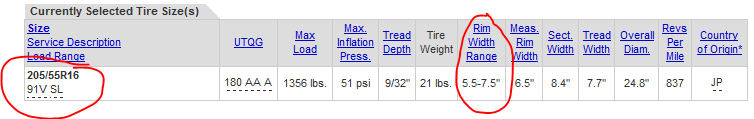

I've never tried a 205 on the front, but I have certainly heard of people who have fitted them. The 205/55 AD08 is on it's limit, when fitted to the standard S2 rims, but it is an approved size.
I recon it will probably work fine.....

steve_weegie wrote:I've never tried a 205 on the front, but I have certainly heard of people who have fitted them. The 205/55 AD08 is on it's limit, when fitted to the standard S2 rims, but it is an approved size.
I think Ali tried 205s a long time ago on the standard 5.5J S2 rims - was a step too far. 195 would be fine.
Personally, I wouldn't risk it.

Yep agree 205's are too wide for 5.5 inch rims. 195's will fit but can't get ad08 in that size. Ad07's are pretty cheap and work well with ad08 rears imo.
If you read the manufacturers spec on tyres they give you the wheel size they will fit. Just google it. :)

steve_weegie wrote:Image
Yep that's right but not the right size. You'd want a 205/45/16 or a 205/50/16 at most and due to the lower profile sidewall they won't fit a 5.5 inch rim.
55 profile would be like off roader profile. :)
There's 41 mm of a difference between the 45 and 55 profile tyres. That's quite a bit. The spec on the 45 and 50 profile tyres say they won't fit a 5.5 inch rim. I agree 55 profile will.
