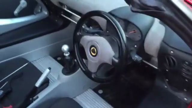

1) My speedo doesn't work & the ABS light & engine management light is on
2) The side lights are permanently on - when you start the car up
3 Sometimes the ignition doesn't turn the car off - and if you push the side lights it turns the ignition off!
see Video clip
(I say that the lights arent on, but they are)
Any input much appreciated
Thanks
David
:roll:
http://s994.photobucket.com/user/a4drk/ ... u.mp4.html

My money is on a fuse ... have you checked them all?

Much less likely to be a relay. If the car has been dismantled then the chances are you've got wiring problems rather than fuses ... it won't be an easy fix (well, it will be easy to fix but it won't be so easy to find).
The speedo could just be one of the wheel speed sensors disconnected (likely given you need to disconnect them to remove the clam).
That would also light the ABS lamp.
The side-light-to-ignition feed is more perplexing, though could be as simple as an earth lead not reconnected.

Craig at mmc reckons it could be a broken wire
That's me got a few options now to look into
