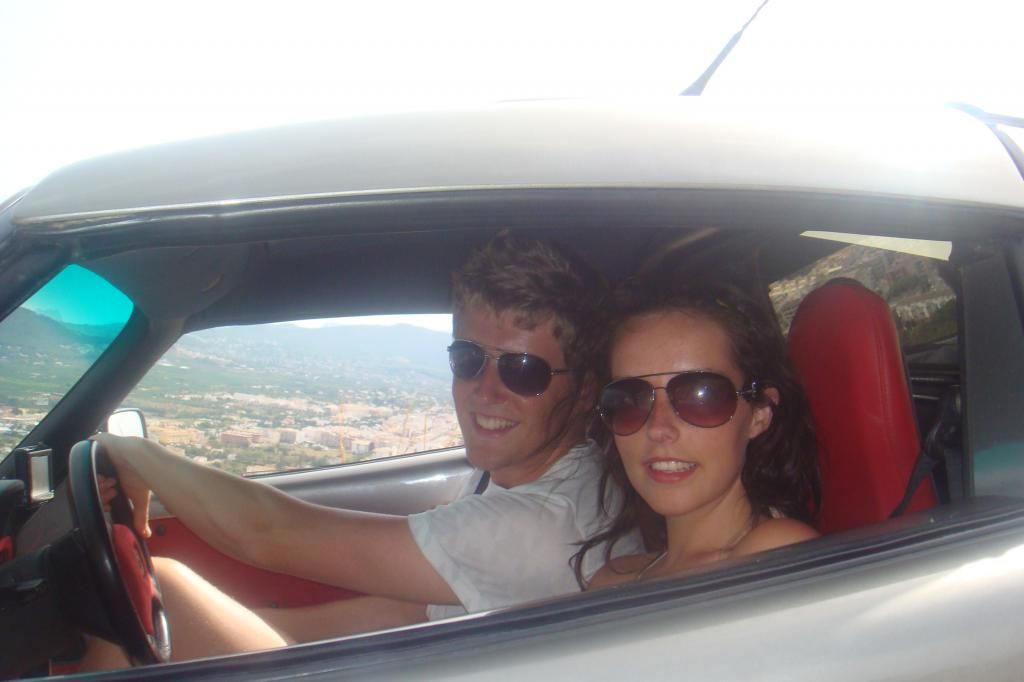

philthy
Posts: 2561
Location: Glasvegas
Re: S1 Exige Windows, many on here?
Post by philthy » Thu Jan 24, 2013 10:47 am
Only picture I could find of mine, even with the right seal it leaked a lot

Posts: 3967
Post by Ferg » Sat Jan 26, 2013 6:33 pm
From that pic it looks to be the same as the factory hard top for the elise. It doesn't do anything special as far as fit is concerned. The window butts up to the square on section of the seal which is maybe as much as 20mm square. It's pretty solid though, not a soft wipe past seal like a modern car.
