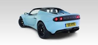

Did some web browsing on Plastidip, don't think it would cope well with the muck and grime although it shows wheels being sprayed in it and does look pretty flexible stuff although really thin in spray form. Might buy a spray tin and have a play and give the rear the Club Racer look though when i have some spare time next summer - always thought there is too much of unbroken area/lines in the earlier S2 rear clam.
