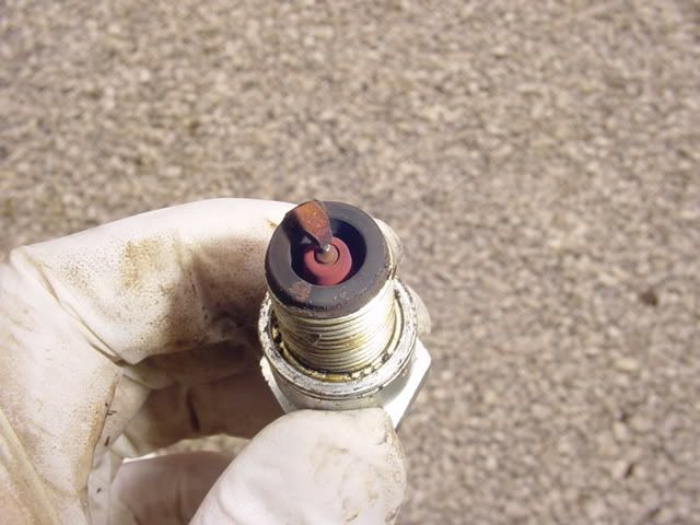

Post by Rich H » Sat Mar 05, 2011 3:04 pm
Any ideas on what could cause this?

Post by philthy » Sat Mar 05, 2011 3:06 pm
Ive seen pink plugs before using fuels with additives like V-power or an octane booster?

Post by Rich H » Sat Mar 05, 2011 3:10 pm
I try to use 'super' petrol or octane boosters... so it could be that...

Post by dirkpitt » Sun Mar 06, 2011 6:38 pm
hi rich,
i have been checking the condition on my spark plugs on the exige and they also have the same red center as yours. i am using momentum 99 petrol and only added some injector cleaning fluid in the last month or so. spark plugs are iridium denso.
so, i m guessing its some additive in the fuel which is causing it?
any more info on your side?
