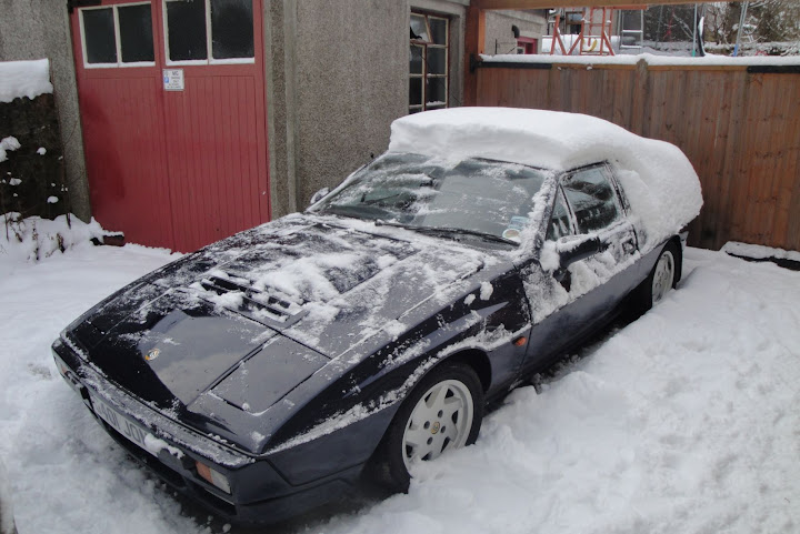

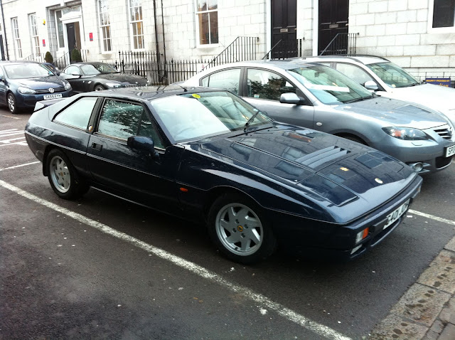

These'll have to do for now - taken with my crappy camera 'phone, having bought the car into work today. Of course, when the other Lotus owner here (you know who you are!) gets his arse back into the office we can get a photo of them together.
Oh, and this comedy one from a couple of days ago, before the thaw!
Richard
