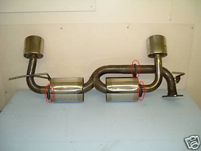

Well whatever it consisted off the anti-rattle kit has done the business and the roof is now rattle free. Not quite Mercedes S Class refinement but very happy :D Also new speaker fitted, new radiator and hazard switch. Whilst it was @MMC I ordered my 1st mod, a Hurricane Induction Kit. Got the car home and had a spare hour so thought I'd break open the box. Not quite as complicated as swapping engines granted but a lot more involved than I expected. After scrounging a 2 tonne trolley jack I had the wheel and wheel arch liner off. About an hour later I was putting the wheel back on all done. Sounded great on the drive so really looking forward to taking it out on the road. Next mod lined up wil be a Larini Sports Exhaust and sport cat (funds permitting) or a de-cat pipe :D

Post by Doc883 » Sun Apr 19, 2009 9:16 pm
AJT wrote:Larini Club Sport on ebay
clicky
The very one but not too sure about this comment "Local pick-up or will dismantle (can be separated into 4 pieces) and courier to the buyer if required".
Anyone advise on this :?:

Re: Anti Rattle Kit ?
Post by AJT » Sun Apr 19, 2009 9:50 pm
Not an issue, the tips are clamped on either side of the silencers, think the inlet pipe also splits.
Should cost about £15 - £20 to have it delivered
