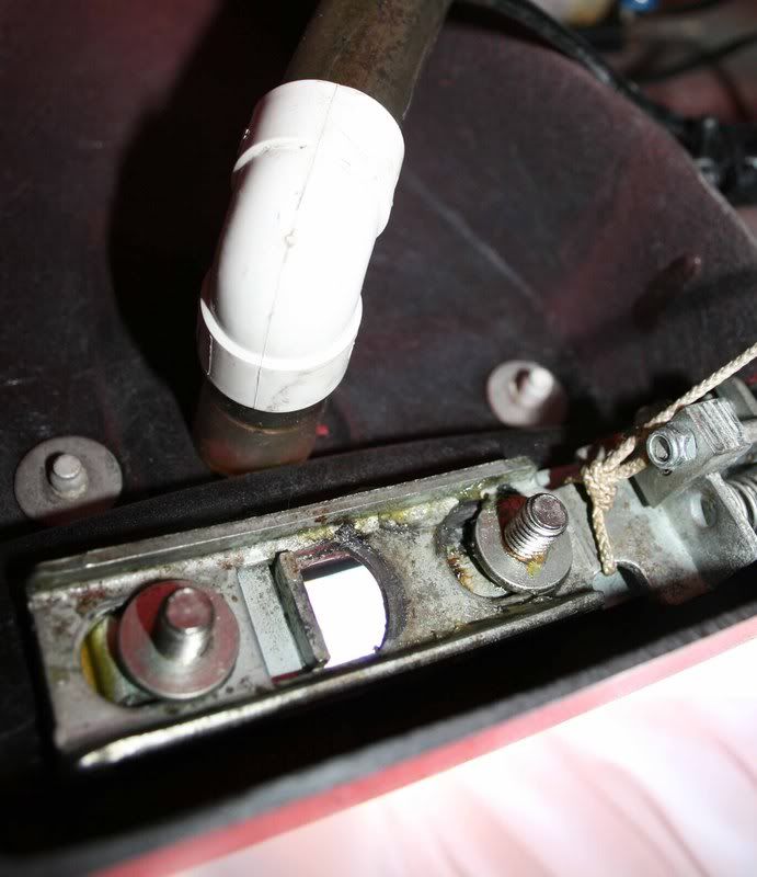

my failsafe is a bit of string fed through to the rear right wheel arch from the hinge slider mechanism.
means i still need to take the wheel off to get it open if it fails due to my ride height, but well better than cutting clams!

Looks pretty similar to the failsafe I added just before the motorfair. I have to pull it pretty hard, but it does work.

okay, so what is it i have to do to add this bit of string?
looks quite a tricky job in itself?
tho 1 worth doing after all my inconvenience this time

All you have to do is tie a piece of string onto the boot latch (as in the photo above, try pulling it to make sure it moves the latch) then dangle the string down one of the holes in the boot, and tie it off on something that doesn't move, so that it can be got at from the outside.andybman wrote:okay, so what is it i have to do to add this bit of string?
Mine is tied off on one of the wheel arch liner bolt holes which was missing a bolt...
I can open the boot by stretching behind the wheel and pulling the cord.

Sounds like something I will do when I get mine back just for safety.Corranga wrote:All you have to do is tie a piece of string onto the boot latch (as in the photo above, try pulling it to make sure it moves the latch) then dangle the string down one of the holes in the boot, and tie it off on something that doesn't move, so that it can be got at from the outside.andybman wrote:okay, so what is it i have to do to add this bit of string?
Chris
