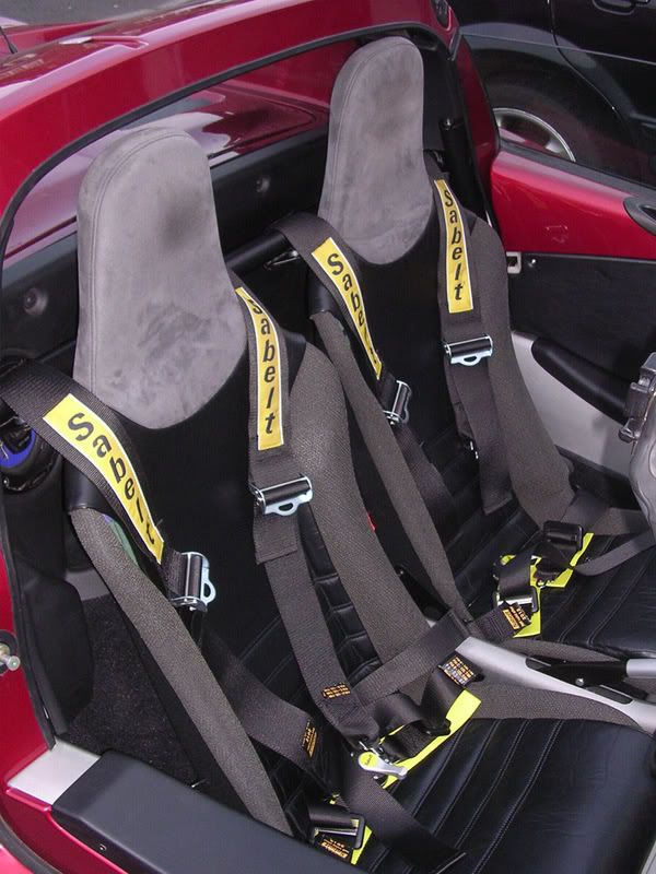

Finally got the harnesses in after all the hastle
Harnesses on back order 'cos sabelt in italy ran out of black webbing.
Harness bar came from eliseparts with a 5p piece sized piece of metal rattling around inside it which had to be removed.
Harnesses originally wouldn't fit with the passenger seat in situ.
Alarm went off every time i opened or closed the garage door ever since fitting the harness bar.
so all in all a right PITA but worth it in the end!
sorted the passenger seat thing by some unorthodox harness routing (which incidentally makes the harnesses much more comfortable to wear!

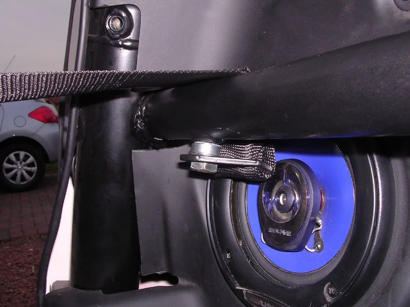

if you look closely you'll see that i had to re-mount the speakers from inside the bulkhead instead of outside it to move them back a few mm to allow enough space for the harnesses to fit.

All worth it in the end, though! - the harnesses are fab!
