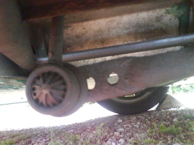

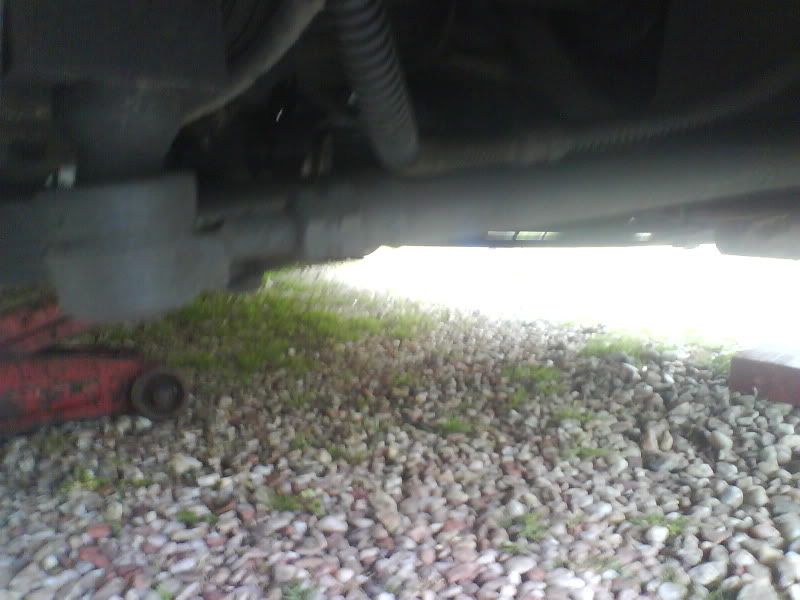

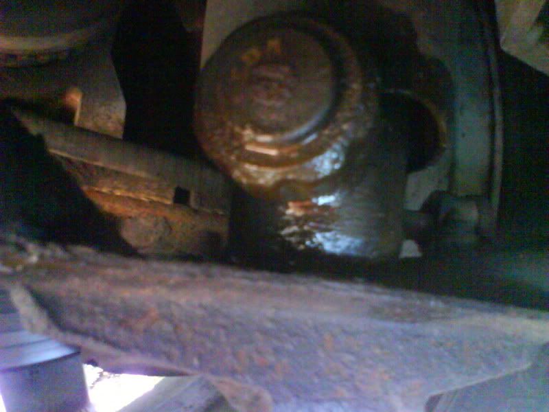

One of the rear shocks is leaking which must not be helping.......

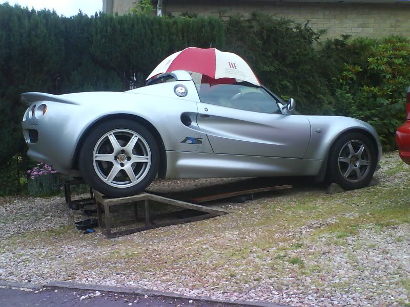

And finally a couple of pics :D

Get the full set of Ledas rebuilt - if you do two, I guarantee that one of the ones you didn't do will leak at the next TD - ask me how I know... Don't expect them to last more than a year once they've been rebuilt, but be budgeting for an upgrade in that time...
