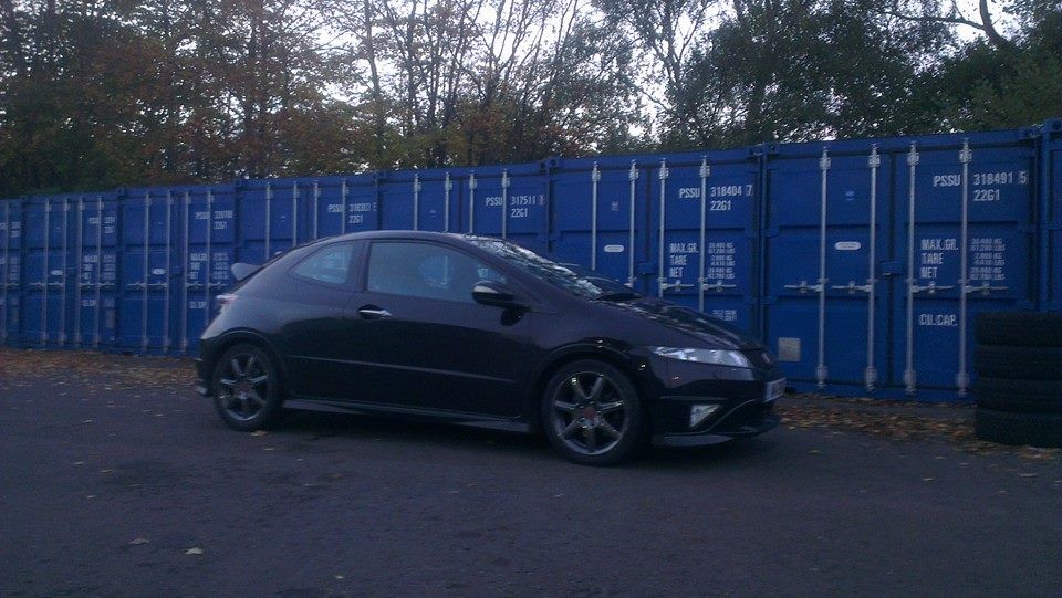

Continental 825s fitted last night on some Civic ES wheels i picked up.
Prefer the look of the 18s but it's not the end of the world.
On the way to work the temp was between 2 and -2 on the A71 and I was really impressed. Threw the car into a roundabout at work that normally results in some scrabbling at this time of year and the thing just gripped.
So far so good.
