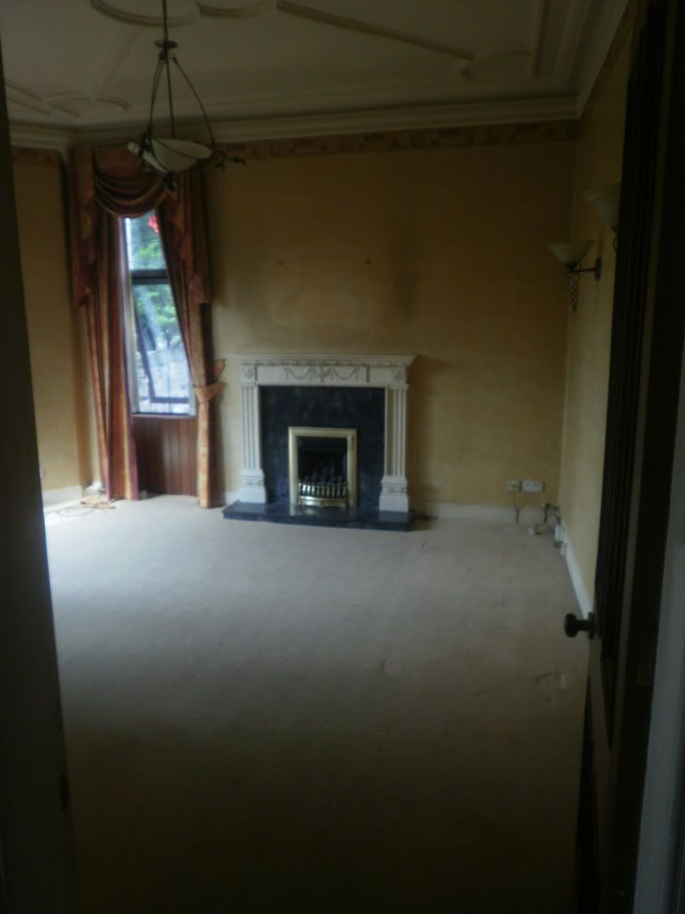

I would be interested in this in the future for my house. The lounge is 17' x 14'6" (5.18m x 4.42m) according to the brochure we had when we bought the house.
As a ballpark figure could someone estimate what would be the value for the complete install. There is a current gas fire there at the moment but I don't think there is any flue in the chimney.
I have just had installed a 35kW Vokera boiler but would be interested in running the heating from a stove for two reasons. Potential to save money and the idea of a nice feature in the home.
Any help or advise would be appreciated.
Pic of the room when we first bought the house, it's strip bare now, but gives an idea of the current arrangement

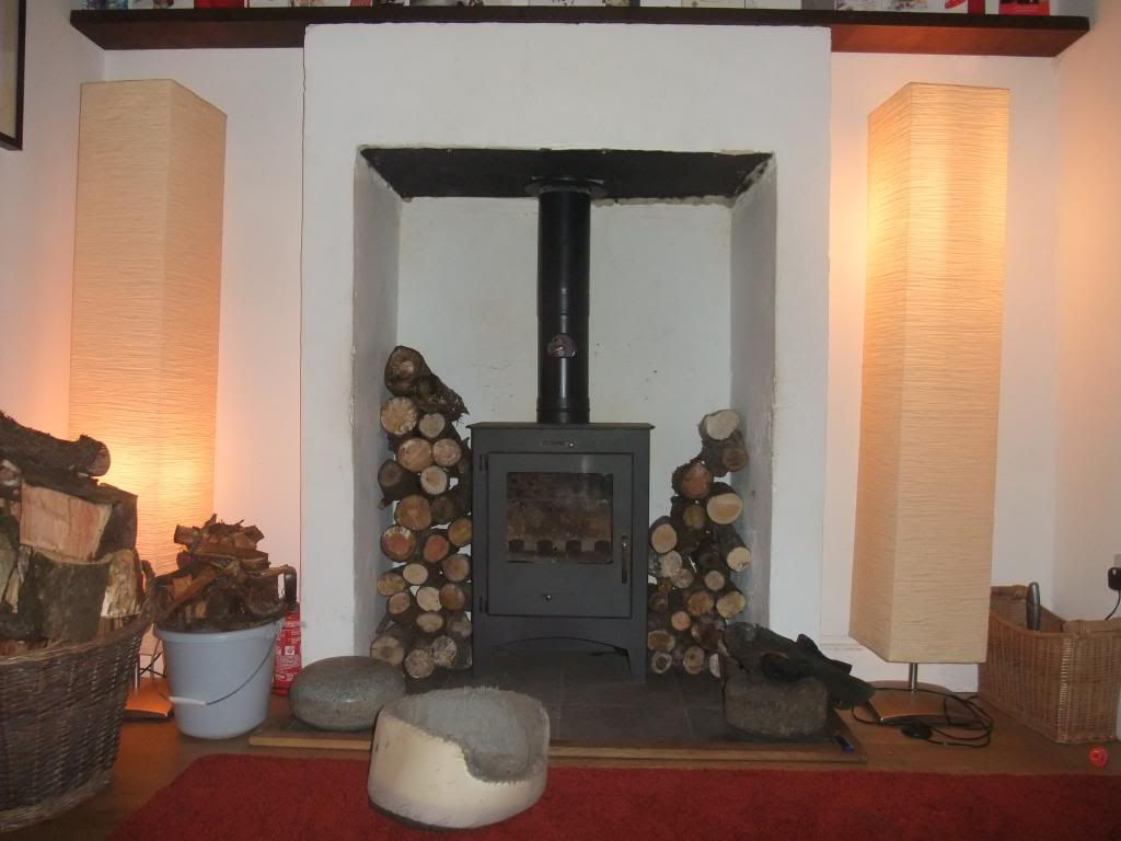

I did a pikey install 18 months ago: took a chance on a cheap stove from an E-bay store, but contrary to the horror stories, it’s been great: it was well described, seems a solid piece of kit and I really can’t fault it so far on quality or performance.
Installed it myself into an existing chimney/fireplace, which was straightforward enough. However, I’ve just added up what I spent and got a bit of a surprise: it’s all the ancillary stuff that bumps the cost up-

Bit more than I realised, actually, but a lot of that is the kit for processing wood: if I was buying in logs then the actaul cost of the install is only £565. Can't complain about that!
Haven’t paid anything for wood yet. Got 6-7 tons from the local cemetery after last January’s storms (the council guys sawed it into manageable chunks then were glad to get it off their hands for a crate of beer). Also spoke nicely to a local builder, who is happy that I raid the timber skip in their yard: they pay to get it emptied, so win/win.
Having used a log splitter in the past I thought it’d also be on my shopping list, but I’ve been pleasantly surprised at how fast splitting is with a decent maul. It’s also extremely therapeutic after a hard week at work:

Very similar to my setup. Is it safe to have the wood touching the stove?!
- bertieduff
- Posts: 2253
Re: Multi fuel stove
Nope!
It's fine up to about half-height...after that it'll burn...
