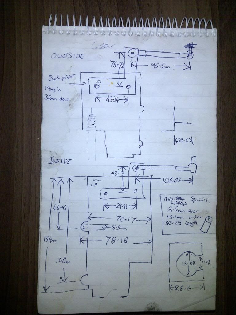

Gear linkage you need something like below, this is using existing cables from the S1. Maybe cost 50 to fabricate? Again Ihave whats needed sitting spare so anyone is welcome to have it copied.
